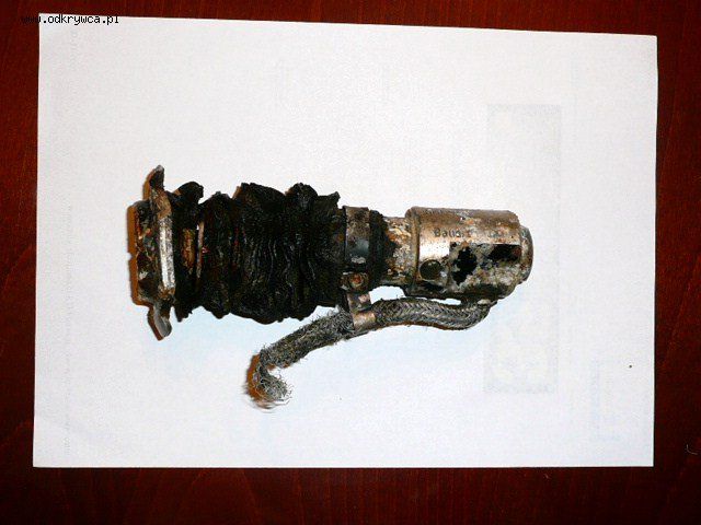

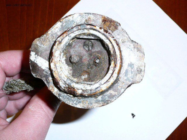

traper6 Posted March 11, 2010 Author Share Posted March 11, 2010 Zwracam się o pomoc lotników.Przedmiot leży na kartce papieru A-4. Wykonany z aluminium i kołnierzem" ze skóry. Najpierw myślałem że to jakiś wlew paliwa, ale po umyciu raczej to nie to Link to comment Share on other sites More sharing options...

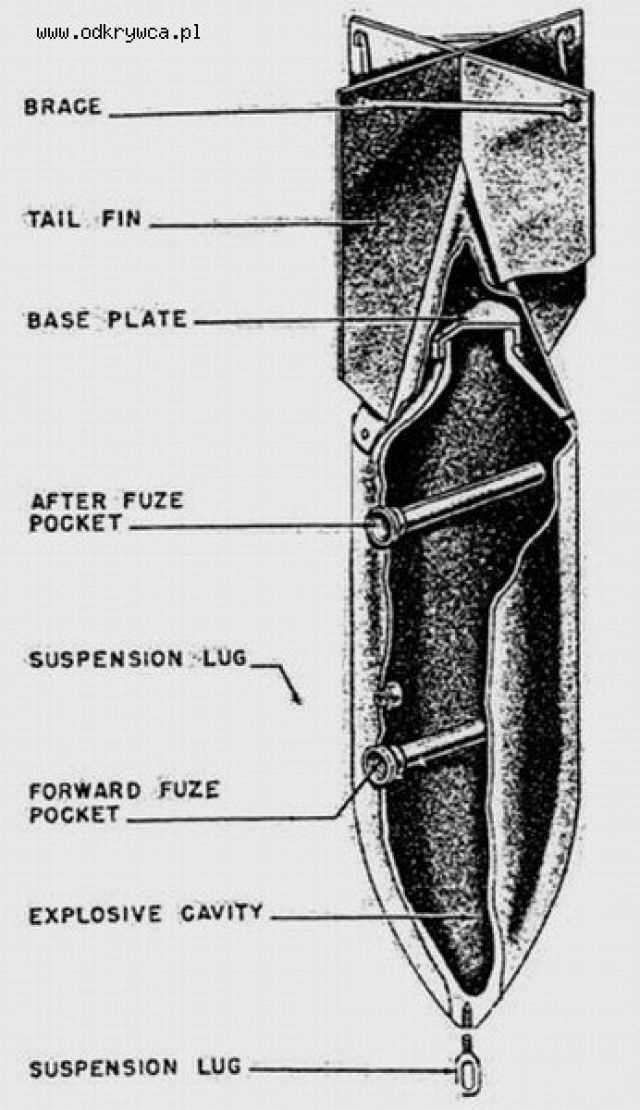

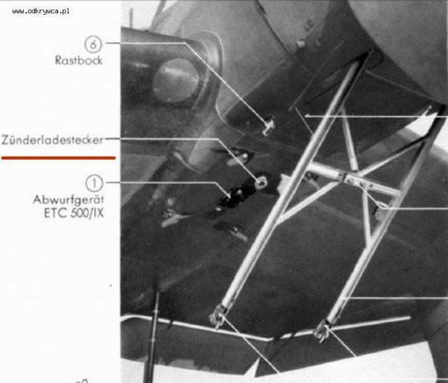

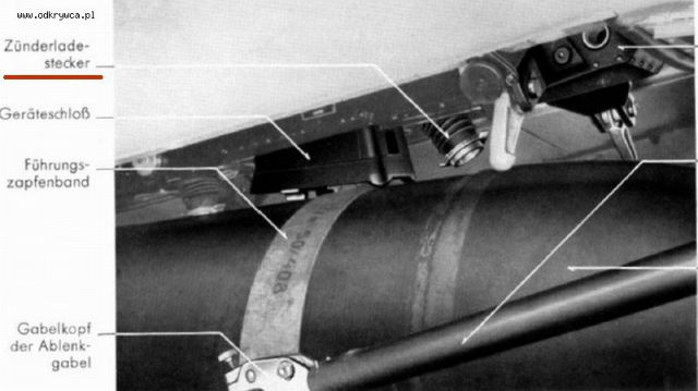

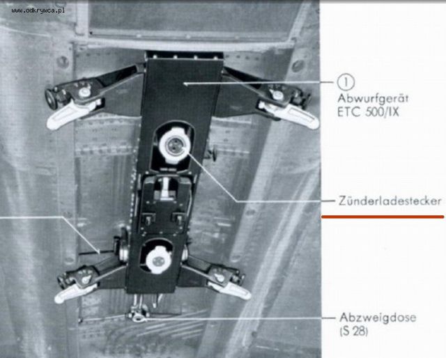

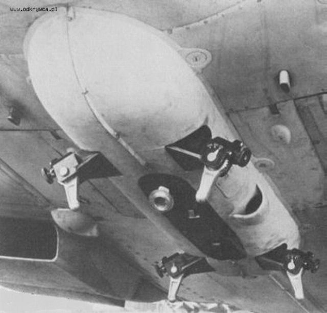

Woodhaven Posted March 12, 2010 Share Posted March 12, 2010 Fl 50571 Zunderladestecker Link to comment Share on other sites More sharing options...
Woodhaven Posted March 12, 2010 Share Posted March 12, 2010 #2 Link to comment Share on other sites More sharing options...
Woodhaven Posted March 12, 2010 Share Posted March 12, 2010 #3 ;-) Link to comment Share on other sites More sharing options...
Woodhaven Posted March 12, 2010 Share Posted March 12, 2010 #4 Link to comment Share on other sites More sharing options...
Woodhaven Posted March 12, 2010 Share Posted March 12, 2010 http://www.lexikon-der-wehrmacht.de/Waffen/PDF/SC250.pdfhttp://www.lexikon-der-wehrmacht.de/Waffen/PDF/SC500.pdfTeraz już sami dojdziecie do czego te kabelki PozdrawiamWood;-)haven Link to comment Share on other sites More sharing options...
Woodhaven Posted March 13, 2010 Share Posted March 13, 2010 W uzupelnieniu mozna jeszcze dodac iz część FL 50571 byla montowana w wyrzutnikach ETC 500 IX przystosowanych do bomb SC 250 i SC 500 w których stosowano zapalnikiEl. AZ 25 B, CEl. AZ 38El. AZ 28AEl. AZ 55 Link to comment Share on other sites More sharing options...

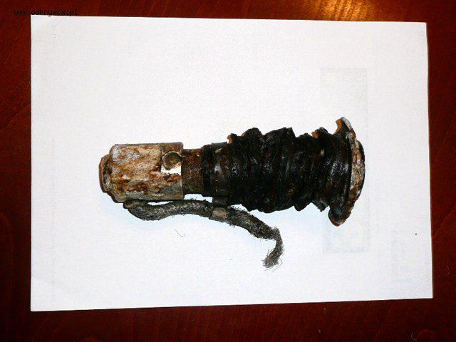

traper6 Posted March 11, 2010 Author Share Posted March 11, 2010 Druga strona Link to comment Share on other sites More sharing options...

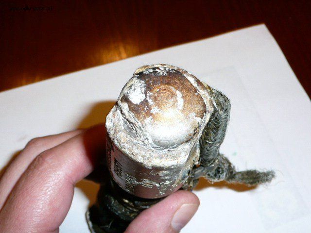

traper6 Posted March 11, 2010 Author Share Posted March 11, 2010 Góra. Jak była w piasku to myślałem że jakiś wlew. A jednak nie. Link to comment Share on other sites More sharing options...
traper6 Posted March 11, 2010 Author Share Posted March 11, 2010 Dół Link to comment Share on other sites More sharing options...

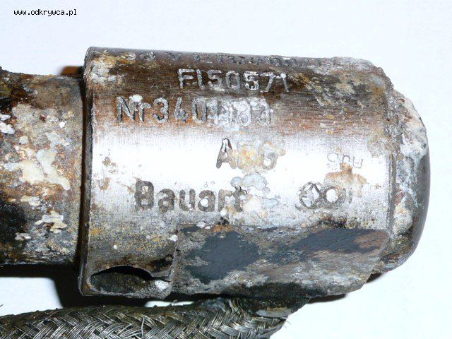

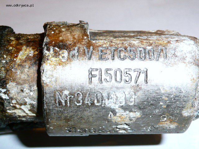

traper6 Posted March 11, 2010 Author Share Posted March 11, 2010 Czy na podstawie sygnatur można zidentyfikować z jakiego to jest letadla ? Link to comment Share on other sites More sharing options...
traper6 Posted March 11, 2010 Author Share Posted March 11, 2010 Lad V ETC500/IXIFl 50571Nr.3401183AEGBauart Link to comment Share on other sites More sharing options...
woytas Posted March 11, 2010 Share Posted March 11, 2010 gniazdo anteny? Link to comment Share on other sites More sharing options...
Kuba_70 Posted March 11, 2010 Share Posted March 11, 2010 Wg. tej strony:http://www.hood.de/auction/36721299/stecker-deutsches-bombenschloss-2-wk-luftwaffe-fl50571.htmjest to lacznik podwieszenia bomb 500kg(nie jestem pewien tlumaczenia...)pozdrawiam Link to comment Share on other sites More sharing options...
PG Posted March 11, 2010 Share Posted March 11, 2010 Zaiste Kuba ma racje :)Traper gratuluję i szukaj reszty letadła" :)Pozdr. Link to comment Share on other sites More sharing options...
RPS Posted March 12, 2010 Share Posted March 12, 2010 Jeżeli w bombie był używany zapalnik 25D to kabel służył do ładowania kandensatora wstąpnego. Wysokość napięcia zasilającego ten kondensator decydowała o czasie po jakim zapalnik uzbrajał się. Szczegóły ODKRYWCA nr.5 2003r. Link to comment Share on other sites More sharing options...
RPS Posted March 12, 2010 Share Posted March 12, 2010 Sorry. Wstępnego" oczywiście Link to comment Share on other sites More sharing options...
traper6 Posted March 11, 2010 Author Share Posted March 11, 2010 Dziękuję Panowie za szybką i bezbłędną ID.Jeżeli ktoś jest zainteresowany wymianą na te ustrojstwo. To zapraszam do mnie na priv. Link to comment Share on other sites More sharing options...
