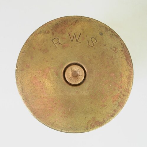

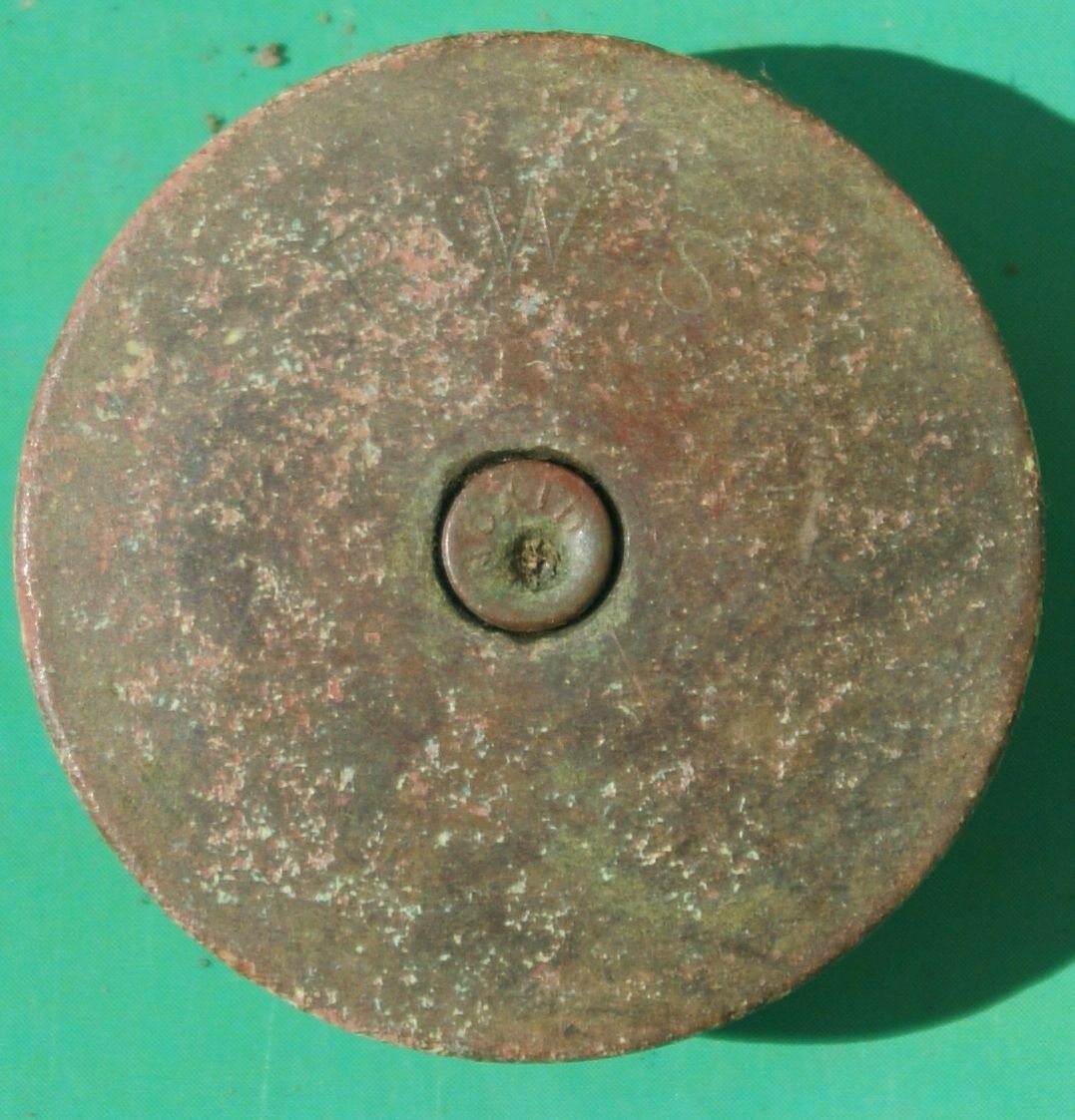

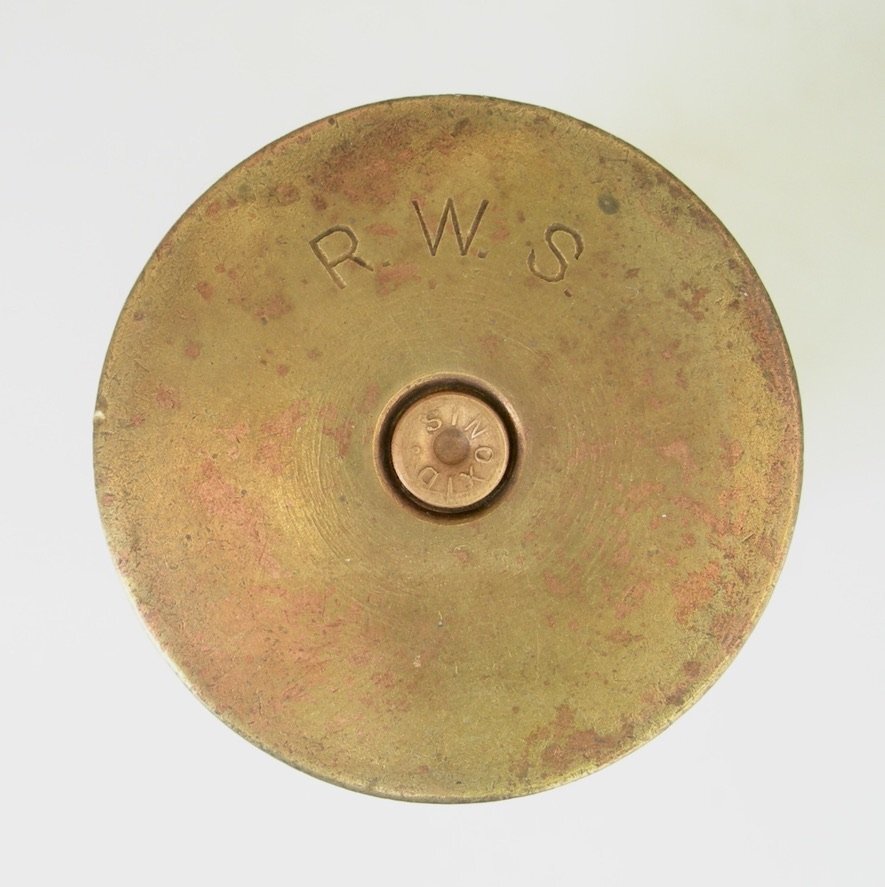

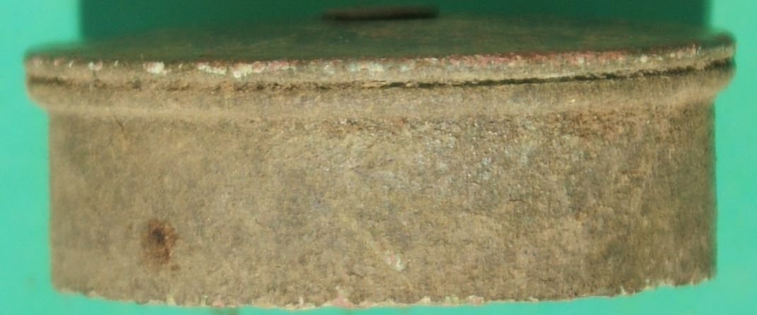

hipolit-O4 Posted May 11, 2025 Posted May 11, 2025 Produkcja R. W. S. Średnica kryzy ok.42mm, pierścienia ok. 41mm. Do czego to mogło służyć?

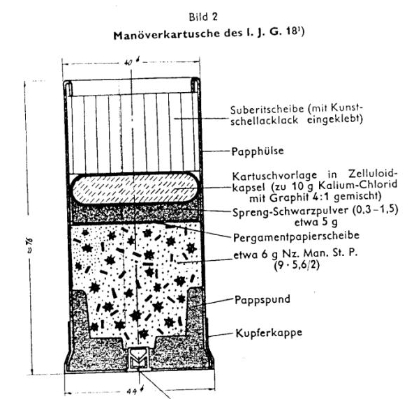

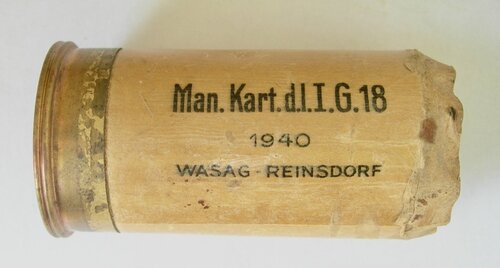

0 combo Posted May 12, 2025 Posted May 12, 2025 Here is a 1940 dated fired case by R.W.S. Rim is 43.6mm and has a groove in the centre of the rim. 3.7mm rim thickness. Base is 40.6mm diameter and 14.5mm high brass. Length is 84.5mm.
