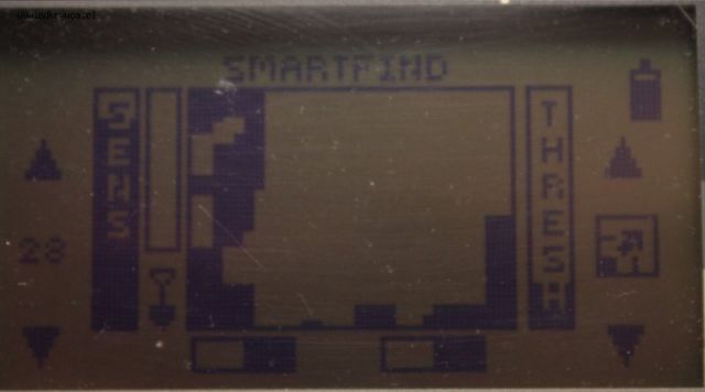

nocnymar Napisano 20 Wrzesień 2013 Napisano 20 Wrzesień 2013 Odświeżam.Explorer SE. IRON MASK: 29 SENSITIVITY: 28/31 GAIN 8 THRESHOLD: 7 RESPONSE: PITCH HOLD RECOVER: FAST+DEEP CONTRAST: 2 VOLUME: MAX LIMIT TONE: 5/8/10 SOUNDS: FERROUS NOIS: 6
