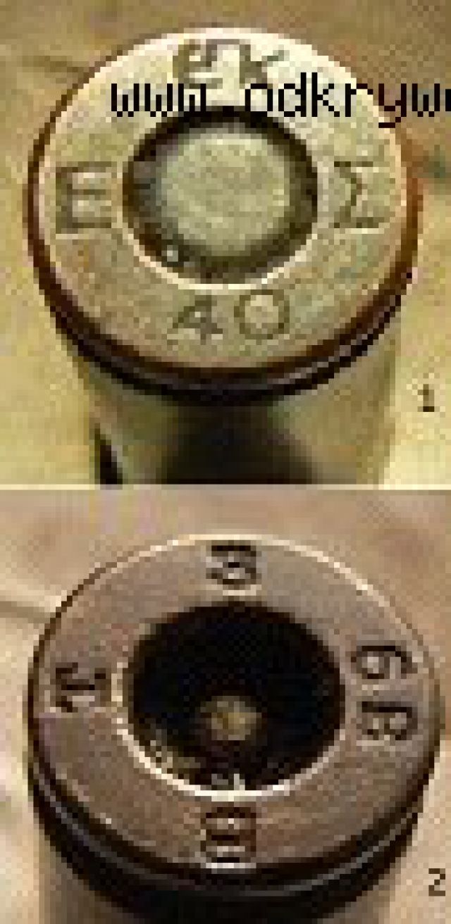

penumbra Posted November 13, 2014 Author Share Posted November 13, 2014 Proszę o identyfikacje.Zapewne sa od mausera . Link to comment Share on other sites More sharing options...

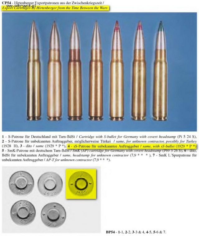

Ave Danzig Posted March 20, 2016 Share Posted March 20, 2016 P * 1924 * to produkcja eksportowa Hirtenberga. Z 1924 i 1925 akurat dla Polski. Link to comment Share on other sites More sharing options...
penumbra Posted March 20, 2016 Author Share Posted March 20, 2016 ta z biciem * 7 D 88 Link to comment Share on other sites More sharing options...

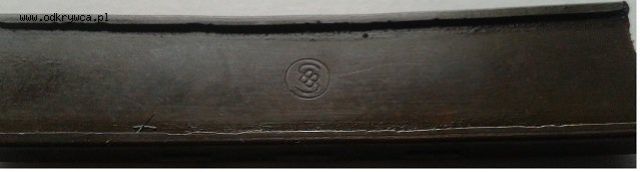

penumbra Posted April 18, 2015 Author Share Posted April 18, 2015 Proszę o identyfikacje, łódka od Mausera Link to comment Share on other sites More sharing options...

penumbra Posted April 18, 2015 Author Share Posted April 18, 2015 i łuska od mausera, czy to fabryka Polte? Link to comment Share on other sites More sharing options...
ylooC Posted February 2, 2015 Share Posted February 2, 2015 I znów skleroza :P25 - Metallwarenfabrik Treuenbritzen GmbH, Werk Sebaldusho Link to comment Share on other sites More sharing options...
bjar_1 Posted November 13, 2014 Share Posted November 13, 2014 Grecka z Elliniko Pyritidopoieio A.E., 1940 r. niżej jugosłowiańska - Wojenno-Techniczeskij Zavod Kragujevac, 1939. Link to comment Share on other sites More sharing options...
penumbra Posted November 13, 2014 Author Share Posted November 13, 2014 dziękuje,czy te okazy sa jakieś rzadkie? Link to comment Share on other sites More sharing options...
bjar_1 Posted November 13, 2014 Share Posted November 13, 2014 No nie za bardzo... Link to comment Share on other sites More sharing options...

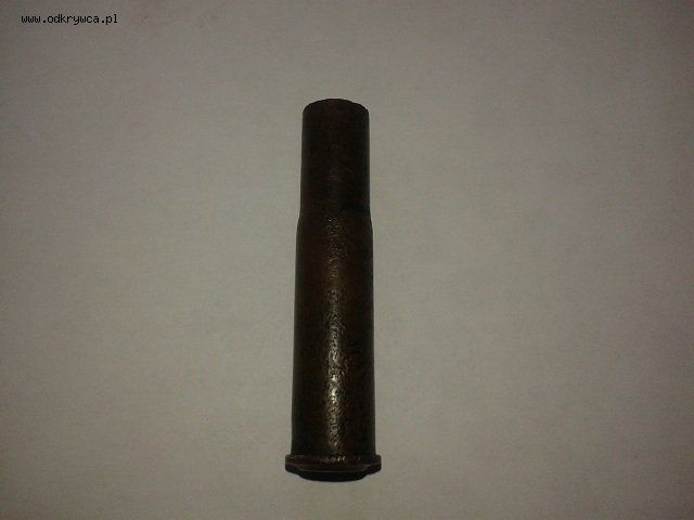

penumbra Posted March 20, 2016 Author Share Posted March 20, 2016 Proszę o id.Kaliber większy niż mauserowski.oznaczenia * 7 D 88 Link to comment Share on other sites More sharing options...
penumbra Posted March 20, 2016 Author Share Posted March 20, 2016 jeszcze jedno foto Link to comment Share on other sites More sharing options...
viator01 Posted March 20, 2016 Share Posted March 20, 2016 łódka Sellier&BellotP = Polte Armaturen und Maschinenfabrik A.G.Łuska wygłada na 11,15x60R mauser 1871http://www.municion.org/11_15x60R/11_15x60R.htm Link to comment Share on other sites More sharing options...
bjar_1 Posted March 20, 2016 Share Posted March 20, 2016 Ta z P" to tak naprawdę nie wiadomo co na sto procent, prawdopodobnie Hinterberg. Link to comment Share on other sites More sharing options...
mensguth6 Posted March 20, 2016 Share Posted March 20, 2016 Hirtenberg miał K Link to comment Share on other sites More sharing options...
bjar_1 Posted March 20, 2016 Share Posted March 20, 2016 H też miał... Link to comment Share on other sites More sharing options...
