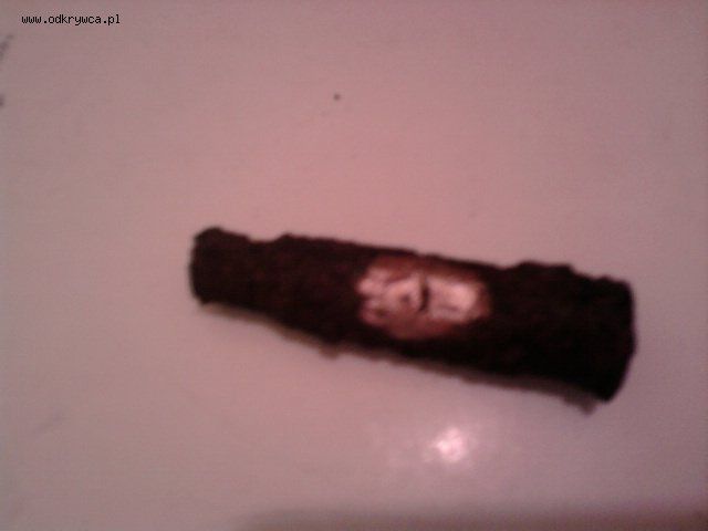

karabin Posted February 19, 2011 Share Posted February 19, 2011 Dziś tylko jedna łuska wyszła stal+mosiądz z 43r. z dna okopu.Jak domniemam radziecka. Link to comment Share on other sites More sharing options...
