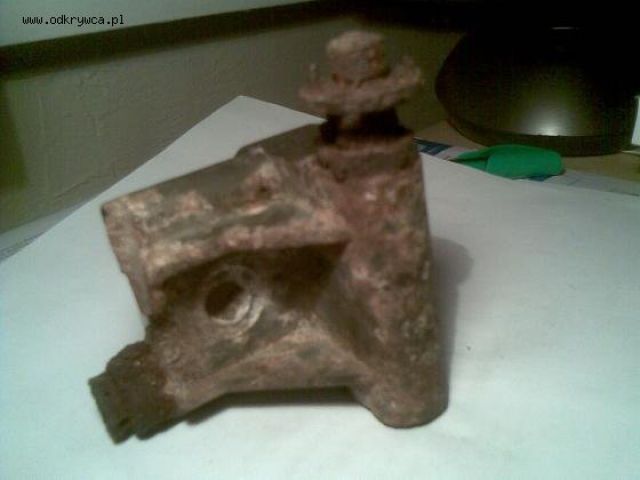

nz Posted December 21, 2008 Author Share Posted December 21, 2008 Witam.Wygląda jak napęd licznika.Sygnowany RA 35 oraz bvo (lub bvu)47852.Proszę o informacje co to jest i od jakiego pojazdu... Link to comment Share on other sites More sharing options...

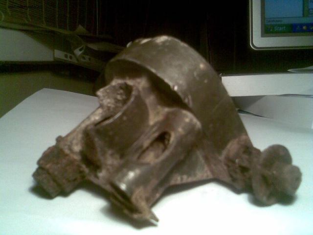

nz Posted December 21, 2008 Author Share Posted December 21, 2008 2. Link to comment Share on other sites More sharing options...

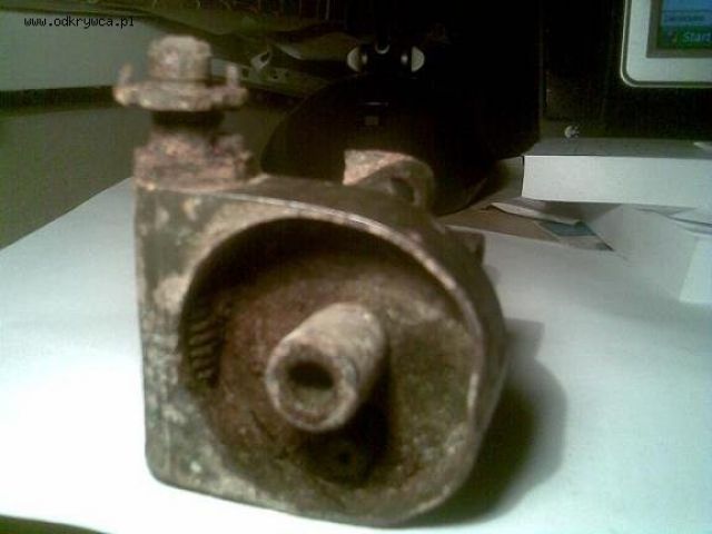

nz Posted December 21, 2008 Author Share Posted December 21, 2008 3. Link to comment Share on other sites More sharing options...

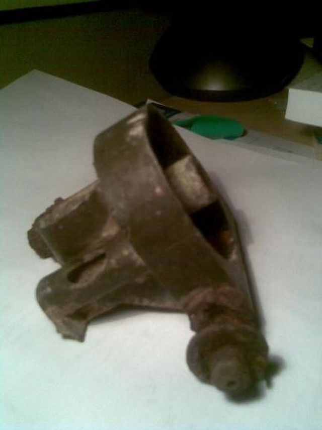

nz Posted December 21, 2008 Author Share Posted December 21, 2008 ..i ostatnie. Link to comment Share on other sites More sharing options...

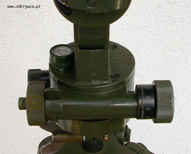

Luftlander Posted December 22, 2008 Share Posted December 22, 2008 bvu to kod producenta Kuhlmann, Franz, Werkstaetten fuer Praezisionsnmechanik u. Maschinenbau, Hauptwerke Wilhelmshaven.Produkował między innymi podstawy pod lornetki nożycowe. Ta część to element z takiego urządzenia. Link to comment Share on other sites More sharing options...
Luftlander Posted December 22, 2008 Share Posted December 22, 2008 Jeszcze jedno zdjęcie. Link to comment Share on other sites More sharing options...
