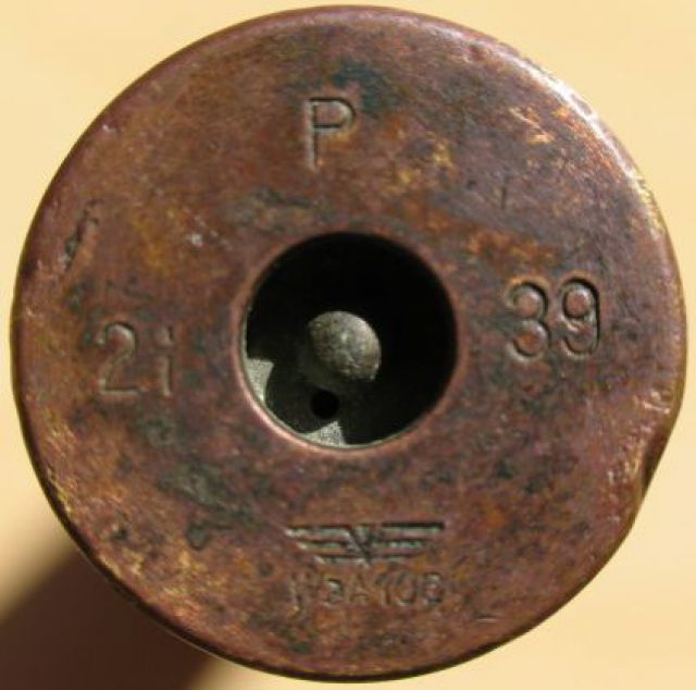

thor65 Napisano 30 Sierpień 2005 Autor Napisano 30 Sierpień 2005 Witam.Dorwałem aparat cyfrowy oto denko łuski 13x94.

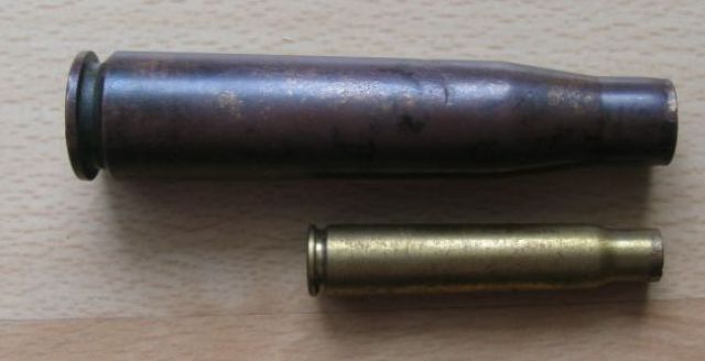

thor65 Napisano 30 Sierpień 2005 Autor Napisano 30 Sierpień 2005 A tu zwykły Mauser 7,92x57 i łuska 13x94.

herrmateuss Napisano 9 Styczeń 2005 Napisano 9 Styczeń 2005 W sumie to ci powiem , że masz unikat bo to był nabój eksperymentalny nawet TONY WILLIAMS'którego są powyższe zdjęcia musiał sobie zrobić replike tego pocisku na podstawie dokumentacji. Nabój ten jest przejściowym między (13x92SR z pierwszej wojny a 7.92x94 PzB) tu fotka wszystich niem.( pierwszy i ostatni sa amerykańskie) pocisków p-panchttp://www.quarry.nildram.co.uk/GerAT.jpg Zarzuce ci cały tekst po angielsku In the 1930s the Germans commenced development of a new anti-tank rifle and cartridge. The starting point was the 13x92SR, the end point the 7.92x94, also known as the Panzerbüchsen or Patrone 318. However, another cartridge was produced; the 13x94, which used a rimless version of the 13x92SR case. This may seem to have been an intermediate development, but it is also suggested that this was deliberately produced to deceive other nations as to the nature of the new 7.92mm ATR, or possibly to help with weapon development. Incidentally, there was also an experimental 7.92mm cartridge made simply by necking down the 13x92SR case.The final cartridge in the group is the .30.50 high-velocity test cartridge (7.62x99), included as a comparison with the 7.92x94.
