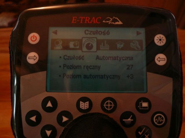

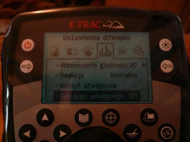

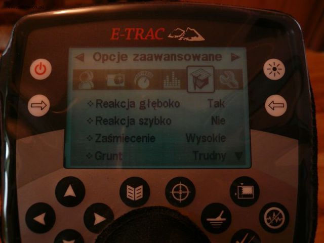

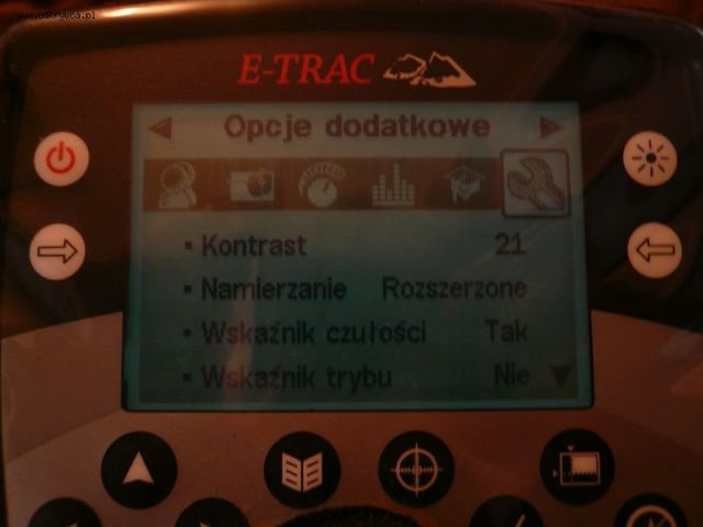

torba5 Napisano 13 Luty 2013 Napisano 13 Luty 2013 sprzęt za parę kloców i zdziwienie że sam złota nie wyciąga :)proszęSensitivity.......Manual Manual level.... 27 (set this to suit conditions) Auto level..... +3 (incase you use auto) Go along to next stage in menu which is Audio. Threshold level... Just Audible Volume limit......30 Volume gain......24 (or less. No higher) Response.......Pitch hold. (or one of the others if you prefer). Go into the Tone ID settings and choose to suit No Tones........multi Sounds...........conduct (ferrous if you prefer) Variability....... 30 Limits............ 30 Threshold pitch...1 Go along to next stage which is Expert. Recovery deep...on Recovery fast.....off Trash density....Low (or high to suit conditions) Ground.......Difficult (or neutral ) Noise cancel......2 or choose 1-10 Go along to next stage which is Preferences. Contrast........15 Pinpoint mode...Normal (or sizing) Show sensitivity...On Show mode info...On Display timeout...Off or On to su
