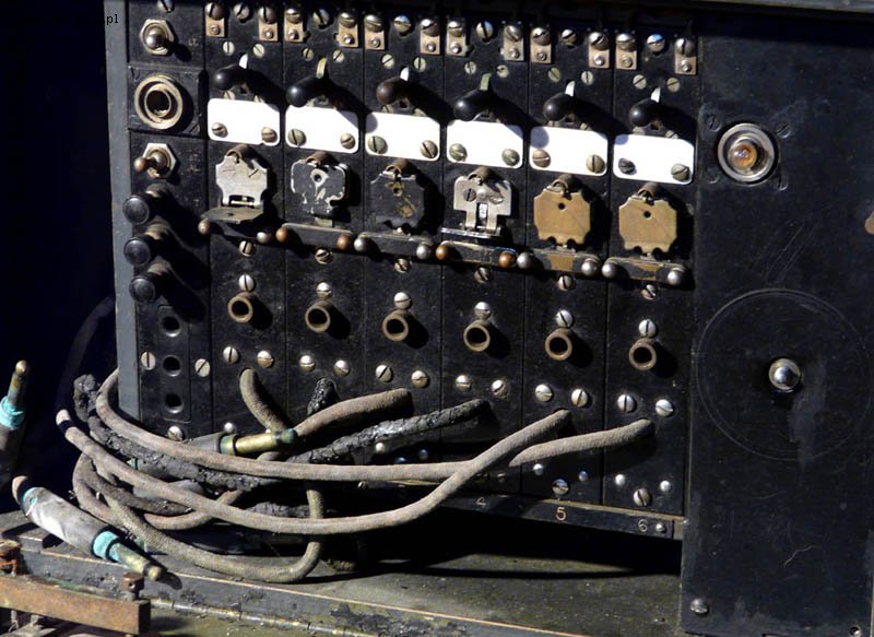

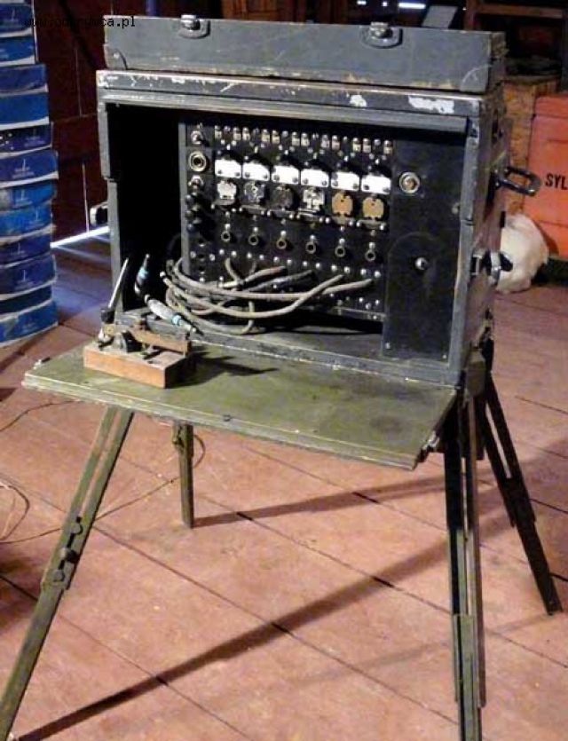

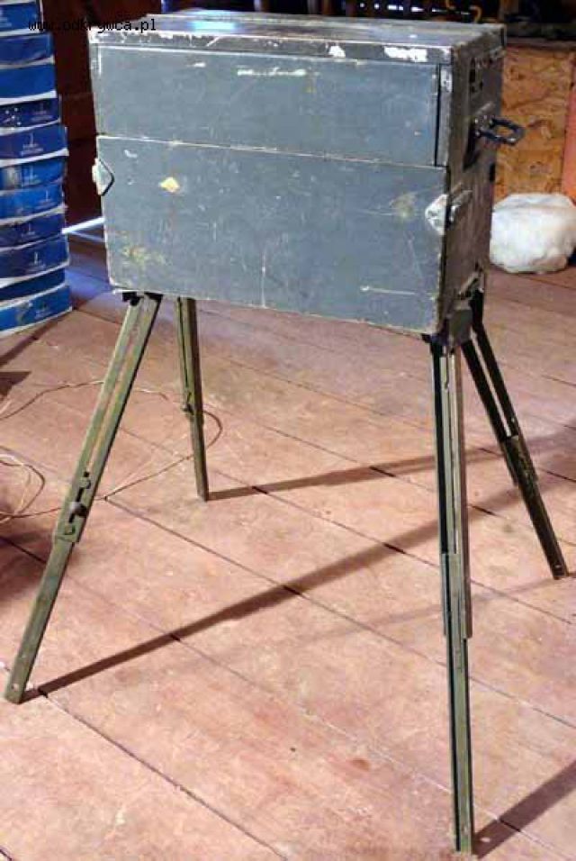

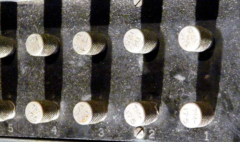

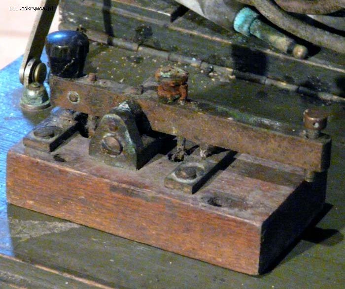

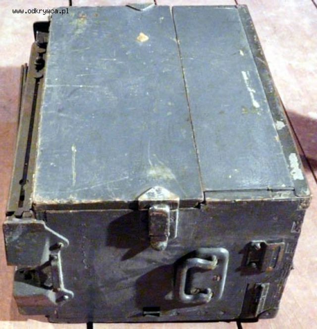

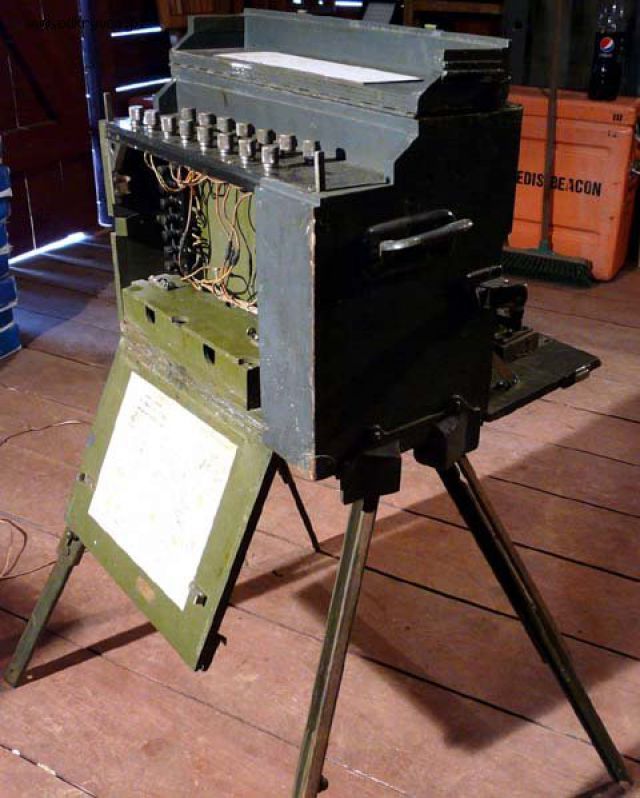

dodo100 Napisano 18 Listopad 2010 Autor Napisano 18 Listopad 2010 Posiadam takie cóś...Wygląda jak polowa centralka telefoniczna.Tylko nie wiem z jakiego okresu pochodzi.Może jakieś sugestie?

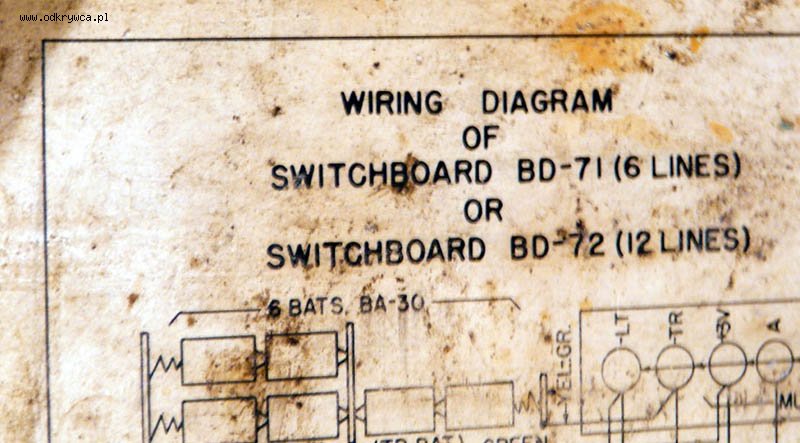

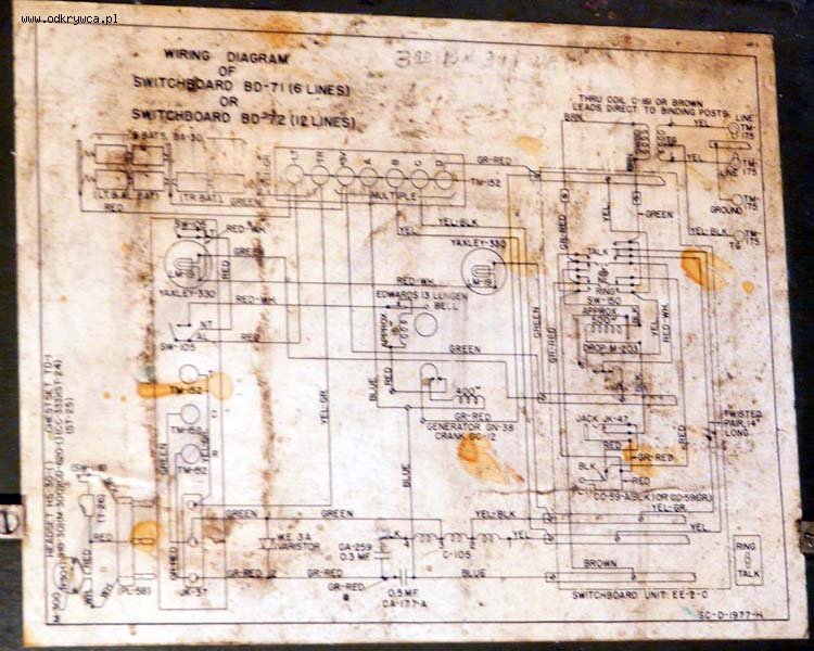

Kobieras39 Napisano 18 Listopad 2010 Napisano 18 Listopad 2010 BD-71 Switchboard, single position, 6 lines.Field or camp monocord switchboard, cabinet style, self-enclosing, with handles and carrying strap; not requiring packing case. Telescopic legs. Total weight about 48 pounds, packed. Equipment is accessible from front, top and rear of cabinet. Line drop acts as ring-off or rering drop. A lamp on each side of switchboard furnishes illumination for night operation. Lower half of front acts as writing shelf and has a sheet of white pyrolin erasable writing surface for diagrams or other data. Trunks to other switchboards must be of the ringdown type. Simplex coils provided on two line units for telegraph or phantom use.Two switchboards BD-71 can be used together to double capacity. Spark gaps provided on lines. Includes hand generator for ringing.usa II wojna łacznica bd 71 odbierz priv pozdr!
